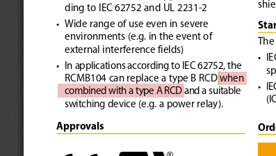

Пока что совершенно не понял вот этот момент:
rcd.png [ 27.53 КБ | Переглядів: 14624 ]
Если модуль позволяет заменить УЗО тип Б, зачем сверху еще одно УЗО тип А?

#81200Повідомлення 07 трав 2019, 22:08
landswellsong писав(ла):
Модуль может замерять то, что может замерить тип Б, но не может тип А и в связке "тип А + модуль" УЗО выступает прерывателем/контактором.
По вашим ссылкам же есть полная инфа. Даже добавить больше нечего. Выделю самое главное:
In the standards for the types of RCD used in Europe, there are three categories:
Type AC.
This only responds to AC leakage currents, of the sort likely to arise in appliances and wiring that have no electronics. It can be purely electromechanical in its internal design (a simple transformer captures the difference between currents flowing in the two wires of the circuit and a third winding on the transformer triggers the mechanism). Most installed RCDs are of this type.
Type A.
This responds to AC leakage currents, and also to pulsed DC currents - as can easily be caused by modern appliances with electronic drive to motors etc. They can be built using the same sort of transformer as before, just needing a bit of electronic filtering to give the required behaviour, so don't necessarily cost any more. There is a slow move to using this type for most applications.
Type B.
This responds to AC and pulsed DC like the Type A, but also to pure DC leakage. Since pure DC doesn't work with transformers, a different mechanism is needed to detect the DC and so Type B units are fundamentally more expensive to make (some designs are also physically bigger).One of the issues is that with pure DC leakage not only will Type-AC breakers upstream fail to trip as a result the DC itself (which might be a minor and unimportant fault), but they will also be 'blinded' (the magnetic core of the transformer becomes saturated) and they won't then trip on any other kind of fault elsewhere in the installation. However, the amount of DC required to make this happen in practice is usually quite a lot more than 6mA. Old test instruments for measuring the earth fault loop impedance used to do this deliberately to avoid tripping RCDs during the test - but they needed to use quite large currents, and many modern RCDs will in fact trip when one of those "no trip" test instruments is used (modern ones do 'no trip' in a different way).
В самих пдф файлах еще раз написано.
